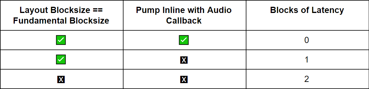

The next step is to integrate real-time audio. AWE Core aside, real-time audio can be a tricky topic. Before attempting to integrate real-time audio into an AWE Core system, please ensure that the integrator has a basic understanding of digital audio and real-time audio processing. Here are some helpful links.
http://www.rossbencina.com/code
Giulio Moro - Assessing the stability of audio code for real time low latency embedded processing
1 << N, for N=0:numThreads-1, to determine which layouts are ready to be pumped. Based on the system's capabilities, each layout should be pumped at it's own interrupt level/thread priority. See the Multi-Rate section for more information.The data type of the input and output audio data is determined by the audio hardware. Typically, digital audio is represented as fixed point data in 16, 24, or 32 bit depth. The audio sample formats supported by AWE Core's awe_audioImportSamples() and awe_audioExportSamples() functions, as defined in AWECore.h, are:
Internally, all inputs and outputs to Audio Weaver layouts are of type Sample32bit, also referred to as fract32 within a layout. This is done to guarantee portability of any signal processing layout to any target system, regardless of the hardware's native audio data type. The awe_audioImportSamples() and awe_audioExportSamples() functions will convert to and from the Sample32bit data as needed based on the integrator's supplied _SampleType argument. If the target's native audio sample formatting is not one of those listed above, then the integrator will have to manually convert the data to one of the supported types before using the import and export functions.

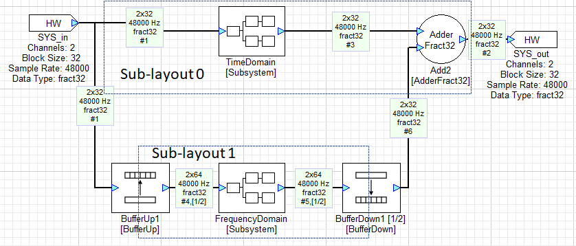

The AWE Core allows audio to be processed at multiple block rates. For example, consider a system with two processing paths: one that processes time-domain data in blocks of 32 samples and another that processes frequency-domain data in blocks of 64 samples but at 1/2 the rate of the time-domain path. Such a system is shown in the figure below. It uses BufferUp and BufferDown modules to connect the different block size domains. These modules effectively partition the layout into 2 sub-layouts operating at different block rates.
The two paths are executed at different rates and AWE Core’s awe_audioGetPumpMask() API call provides a mechanism to determine when the processing for each path should be initiated. Consider the following pseudocode:

This code tests which sub-layouts have accumulated enough data to execute. The layoutMask variable contains a 1 in each bit position corresponding to sub-layout that is ready to execute. For example, if layouts 0 and 1 are ready to execute,
layoutMask = 0x00000003

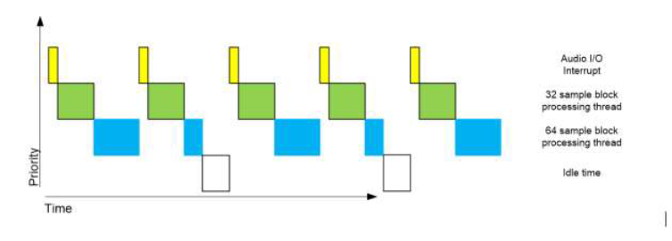

Lower numbered sub-layouts correspond to smaller block sizes. In the pseudo-code, a signal is raised for each sub-layout that is ready to be pumped.
Real-time constraints dictate that if the 64 sample sub-layout is executed in the same context as the 32 sample sub-layout, both will need to complete processing before the next block of 32 samples arrives or real-time will be broken. This imposes an unnecessarily strict constraint on the 64 sample sub-layout – its processing need only be completed before the next block of 64 samples is accumulated. Thus, its processing time can, in principle, be spread over 2 of the 32 sample block times without breaking real-time. In practice, this is achieved by executing the two sub-layouts in separate contexts. The sub-layout with the shorter block size should have higher priority so that it can preempt the processing of the sub-layout with the longer block size. In this way, the real time constraints of each sub-layout can be accommodated. The following figure shows the timing for this example:

This section discusses only the latency caused by the AWE Core framework. The signal processing flow, the firmware, and the hardware can all introduce additional latency to the overall system. In this discussion, a "block" of latency refers to the layout block size and the systems sample rate. For example, with a layout block size of 256 and a sample rate of 48 kHz, the latency through the AWE Core system will be in multiples of blocks of (256 / 48000) = 5.33 ms. AWECore can introduce up to 2 block’s of latency, but can also be configured to achieve 0 blocks of latency under certain conditions.
There are 3 possible latency situations introduced by the AWECore library
Which of the three latency paths will be taken depends on some conditions in the implementation of the AWECore API, and the relationship between the system and the signal processing layout.
Note: The following abbreviations may be used for these AWECore API calls:
To achieve 0 blocks of AWE-induced latency, the following three conditions must be met:
AWE Core has an internal double buffering scheme on the input and output pins to handle situations where a layout’s blocksize is a multiple of the AWEInstance’s fundamental blocksize. For example, a system with a 64 BS layout running on a 32 fundamental BS AWEInstance must complete two, 32-sample audio callbacks before actually pumping audio through the layout (to satisfy the 64 samples). Double buffering is used in this situation in order to store the next frames of data in one buffer, while the processing occurs on the data in the other buffer. Two blocks of latency are introduced by this double buffering of the input and output pins.
However, in a situation where a layout BS is the same as a fundamental BS, the double buffering scheme is not required and two blocks of latency can be avoided. AWECore has an internal mechanism to check if the layout and fundamental blocksizes are equivalent at layout runtime, and will automatically bypass the double buffering to eliminate the introduced latency. Less memory is also consumed under this condition as only a single buffer can be used at the input and output pins.
At a very high level, 0 blocks of latency can only fundamentally be achieved if all of the audio processing occurs in a single callback. Based on this, the audio processing function must implement the following order of API calls to achieve the lowest possible latency: awe_audioImportSamples() awe_audioGetPumpMask() && awe_audioPump() (can be a signal to lower priority threads to do actual pumping) awe_audioExportSamples()
Different orders of API calls will still operate correctly from a processing standpoint, but may not achieve the lowest possible latency.
Virtually all systems that integrate the AWE Core will use a thread signaling or interrupt raising scheme to trigger awe_audioPump in separate, lower priority contexts from the main DMA audio callback. While this scheme is required in order to allow for efficient, multi-rate operation of signal processing layouts, it does mean that the processing of the audio signal will not be complete by the end of the audio callback, As mentioned in the section above, a system with 0 blocks of AWECore induced latency must complete all audio processing within the context of the main DMA audio callback. So in order to achieve minimal latency, the first sublayout (layout index 0) must be executed in place during the audio callback, not in a lower priority context.
The first sublayout consumes the input pin and fills the output pin, so it is only this layout that needs to be processed in place. Other non low latency paths (clockdivided sublayouts, layout index > 0) should still be signaled by the callback and pumped in another context.
